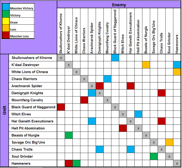

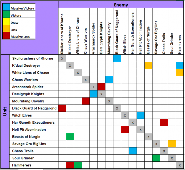

Show time! In this matchup we pit the Witch Elves against the Hell Pit Abomination.
Key rules in play:
- Witch Elves: ASF, Frenzy, Murderous Prowess, Poisoned Attacks
- Hell Pit Abomination: Regeneration (4+), Special Close Combat Attacks, Stubborn
In this matchup, the Hell Pit posed an interesting problem for the calculations. The Hell Pit has the rule "Special Close Combat Attacks", which means that it rolls a D6 to determine which of its special attacks it performs in that round of combat (like a giant does)...
- On a roll of 1-2: Feed
- On a roll of 3-4: Flailing Flesh
- On a roll of 5-6: Avalanche of Flesh
So each set of attacks has a 1/3 chance of being rolled for. The best way I thought to tackle this statistically is to have the Hell Pit do all three sets of attacks each round, but reduce the damage (unsaved wounds) it does to 1/3 of normal. This will provide us with the average damage that the Hell Pit would do. To facilitate this, you will notice that a new column (fourth from the left), called "Hell Pit Special Attacks Probability", was added to the table.
Important note: When the Hell Pit dies and provided that the Hell Pit did not lose any of its wounds to flaming attacks, it's "Too Horrible To Die" special rule takes effect. A dice is rolled:
- 1-3: Nothing else happens
- 4-5: D3 Rat Swarms are placed within 3" of where the Hell Pit was slain and at least 1" away from enemy units
- 6: The Hell Pit comes back alive with D6 wounds. It is placed within 3" of where it was slain and at least 1" away from enemy units
There is no way that I could think of to accurately and fairly incorporate this rule. As a result, the rule was simply ignored. So just keep in mind, that in this matchup there is a 1/6th chance that the Hell Pit could come back alive with D6 wounds!

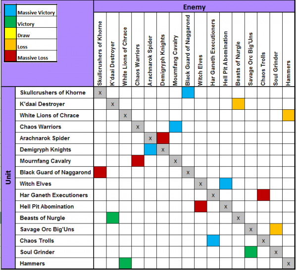

Updated table...
And with that, the only two units that have yet to fight are the Savage Orc Big'Uns and the Soul Grinder. They'll be next up.
Most importantly... Thoughts? Concerns? Discussion!!![]()
