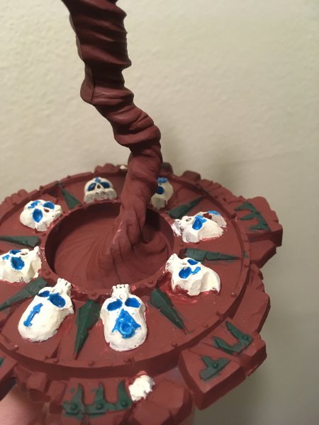

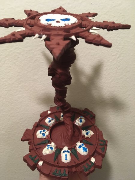

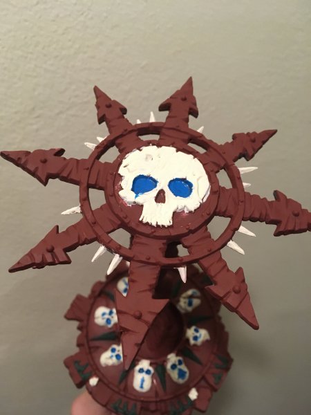

Definitely an improvement, many parts now have better coverage of the paints and you cleaned up some of the spots where the paint didn't follow the lines of the model.
What really needs some more basecoat work is the bright parts such as the horns.
Keep in mind that painting a very dark color over a bright one or vice versa (in your case especially the blue, white, and light brown) often requires several coats of paint to properly cover.
Try to carefully build up the layers (always waiting for it to dry and then add another coat) until there is no black showing through anymore.
I see you used a light brown to drybrush the white bone.
It looks like the drybrush worked in principle, as you see it puts the color just onto the raised areas. I am sure you already noticed how it makes the areas look more detailed than you actually are able to paint directly (at least without being very good in edge highlighting, but that's for another lesson), and that's exactly what the technique is good for.
Now, the "problem" with that is that usually the goal is to make the raised area a lighter color, as if light catches on it, while making the recesses darker using a shade. You occasionally want it to be the other way round but that's not the norm.
I think the effect it has on the white, making it look less uniform and more like the rotting bone it actually is, adds to your model. In the future you will most likely change that recipe a bit, but I'd say it is an improvement over the plain white you previously had.
