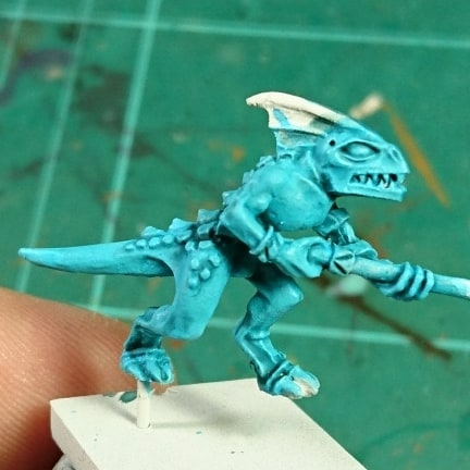

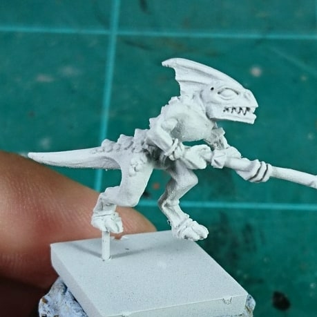

1- Undercoat with a white spray, I use Corax White from GW

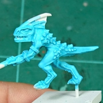

2 - Basecoat with the amazing Baharroth Blue (love it)

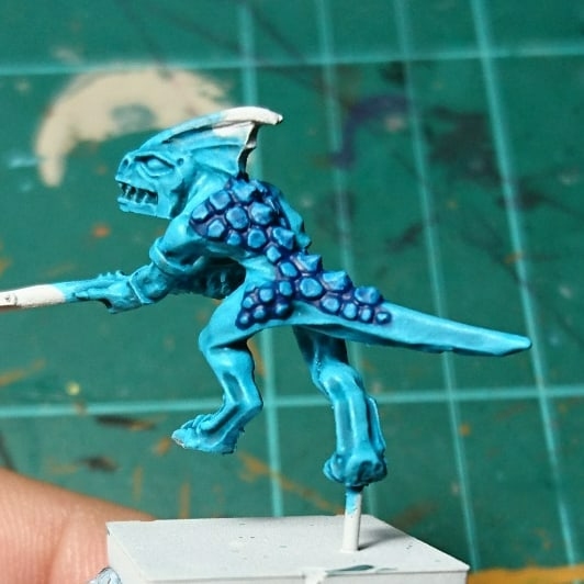

3 - Wash with a 3:1 mix of Lahmian Medium and Temple Guard Blue
4 - Wash with a 2:1 mix of Lahmian Medium and Coelia Greenshade
5 - Wash the scales with a 3:1 mix of Lahmian Medium and Kantor Blue

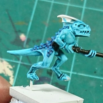

6 - First Highlight on the skin is Baharroth Blue

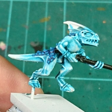

7 - Second Highlight is pure Ulthuan Grey, applied as a heavy Glaze, no mixing whatsoever. Except for the tail all is done with a single brushstroke for each Highlight, tail has two to emphasise it. Key to this technique is how you move your brush, paint will deposit more where the brush stops so you MUST move the brush from the darkest point to the place where you want the most highlight to be.
Hope that it's helpful!
Thanks for watching!!
