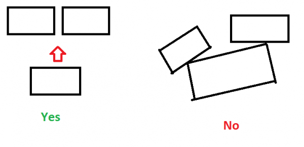

I did not know about the 2x movement reform, that is a good "did you know"! The reform was on the turn previous to the charge, so that aspect was legit. Like was mentioned, a unit in the way fails the charge, but he did a partial wheel then came forward contacting both units at once. A picture would probably be worth while here. Perhaps ill move this question to the rules section to be better hashed out.

I would say here that the partial wheel should have stopped 1" away from the non charged unit, then you unit that was charged closed the door up to his unit.
That is assuming his unit managed to make contact with the corner of the unit it charged?
If it couldn't get into base to base contact the charge wasn't allowed.

A charge can bring you into combat with two different combats, but that almost always happens because the player receiving the charge wants it to happen.
The units being charged have to be "holding" the same line. When unit A charges into unit X and the only way for those two units to be in contact with each other is if unit A is also in flush contact with unit Y then both X and Y have been charged.
However, you can't wheel yourself into a position where you hit both units at an angle and force them to close the door into you.
The second unit to be charged can't close the door. It has to be incidental contact that brings them into combat. Otherwise, the charging unit has to wheel in such a way that it does not get into that combat, or it is a failed charge (the charging unit can't reach their target)
