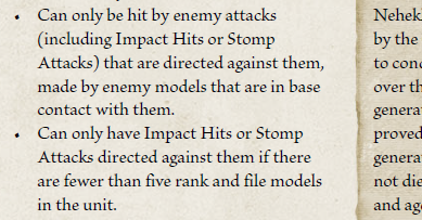

Impact hits can hit your character, but only if they are in base of contact. So yeah you can potentially die of them before to attack =)

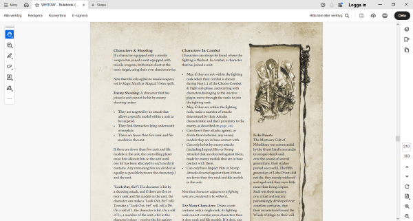

You might want to double-check the “characters in combat” rule — it says:
  • (Characters)Can only have Impact Hits or Stomp Attacks directed against them if there are fewer than five rank and file models in the unit.
So unless I’ve missed something, as long as you’ve still got 5+ regular TGs in the front rank, your hero won’t be taking those Impact Hits at all (even if in base contact). Of course, another enemy hero can still cut him down in normal combat, that’s a different story.
And yeah, I agree — TGs might only do 1–3 wounds against high-T targets. Smashing high Toughness with infantry is never the job they excel at. If that happens, it usually means your Carnosaur didn’t do its job, and the Slann failed to cast anything useful (which, to be fair, is all too common ).
You right, i just read the first sentence.
