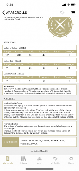

I don’t know if this has been FAQ’d, however I was reading the warscroll and Instinctive Defense doesn’t specify ENEMY charge phase.
Does this mean you can use something like a Skink Starseer to grant them 3D6 charge, a Skink Priest to give them Shoot AND run AND charge... and a Starpriest for Mortals....
Then run them up the table and shoot 2D6. Then comes charge phase and so long as you were outside of 3” if you make the charge and now are within 3” you can shoot D6 and -1 Rend and then melee with their tail? So that’s like 2D6 + 1D6 + 3 attacks all in one thing?
This is like kind of good right?

yep it has not been changed yet so you can shoot twice and then fight it's not bad againsed low armor units
That’s how it works, yup! The issue is the amount of wounds you’re likely to do, compared to a salamander which costs the same.
The one edge case where this is helpful is if you have a pack of 3 in a meeting engagement. If you can manage 5 wounds in the charge phase (which nets you a VP) that’s kinda nice.

It is alright, but the problem is that they cost the same as Salamanders, and with 3D6 shots (assuming you charge and shoot) they still on average unbuffed only do half the damage Salamanders put out. Starpriest will up their damage abit, but for 1 Starpriest you can add another Salamander and some change.
In Coalesced you even have the added benefit of Salamanders having a jaw attack, so they get an extra in melee.
meh, razordons have 1 advantage over salamanders, they don't have the same giant target painted on them. You might get some use out of them like this as a supporting unit that doesn't draw attention to itself, but does do a decent chunk of damage, especially to squishy stuff.

Razordons also have range advantage over the salamanders, which makes them better at heroe sniping. And unlike chameleons, they wouldn't dissolve because someone looked in their direction. Still too random to be reliable, imo.

If you want to roll with some Razordons, I would say go for it. I havent done the math but I would assume the Starpriest venom is great due to the volume of attacks.
My honest opinion is that there is no scenario where Razordons are ever better than Salamanders. Even the range isnt really a factor, because if you want range the Bastiladon is better at that, does reasonable damage and has really good survivability.

As a general startegy: blocks of saurus supported by razordons. Saurus go into melee, razordons provide ranged support and snipe the occasional character. Works for both knights & warriors.
Especially knights + razordons should work well. They are equally fast so they can run up the board together the razordon softening up targets before you charge them. Salamanders in this particular scenario are less interesting as they have far bigger a target painted on them (and are thus more likely to get sniped themselves) and the bonus attack during charges is what's most usefull here, both offensivly and defensivly.
The main thing to take into account here however is that razordons won't be the star of the show. There just there to support.
There's also the potential of sticking some razordons in your 2nd line to deter a potential charge. If your block of 40 saurus is followed by 3 razordons it'l be a hell of a lot scarier to charge. 3D6/3+/4+/-1/1 attacks are not something you'd want to be launched in your face for free. This could be increadibly usefull to guide your opponents charges.
