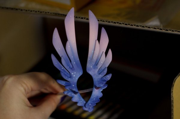

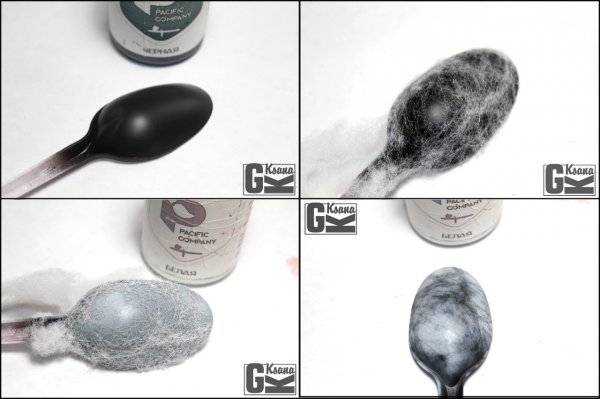

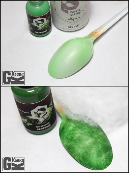

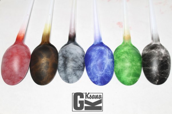

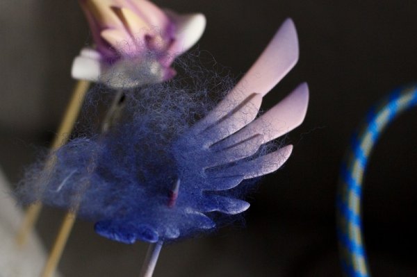

So this is a random find on the internet, but anyone ever experiment making marble effects with what looks like cotton balls?
Unfortunately I do not speak nor read Russian, but from what I can gather in the pictures that looks like airbrush paint? Seems like a simple method; pull a bit of cotton ball over a lightly-based object/model part, spray, then remove cotton swab pieces for a nice marble effect.
