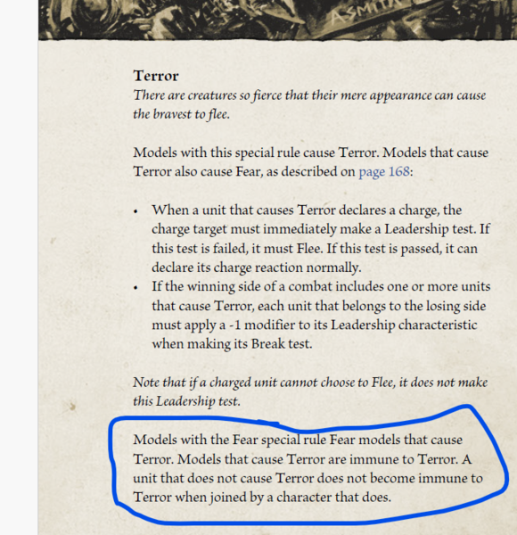

Is this the 18/07 Version 1.2 FAQ? If so then from what I can see Terror still seems to be as per the rulebook - like 8th but with a -1 penalty to Leadership for any unit that loses combat against the Terror-causing unit.
Lol I could not have been more unclear could I?
"Units with fear fear units with terror" means they do not suffer terror, they instead suffer fear.
Previously it was thought units with fear both feared and was terrorised by units with terror
Yep that's definitely the case in both 8th and TOW - here's the original mention of it in the TOW rulebook: upload_2024-7-29_18-30-37.png
Yep that's definitely the case in both 8th and TOW - here's the original mention of it in the TOW rulebook: View attachment 151587
A lot of people played it "the 8th way" out of habit. But most of the community (including all YT battle reports I've seen and the official Australia tournament rules) thought this was a new rule designed to further increase the power of monsters. If you read what you've posted literally, it never actually says models with fear do *not* suffer from terror. Only that they still fear models with terror.
Funnily enough I was the lone voice in the Australian chat sure they meant it as the 8th version and it was bad writing. But I had to concede to a literal reading of RAW. And now 1.2 of the FAQ is out, I'm gloating...
