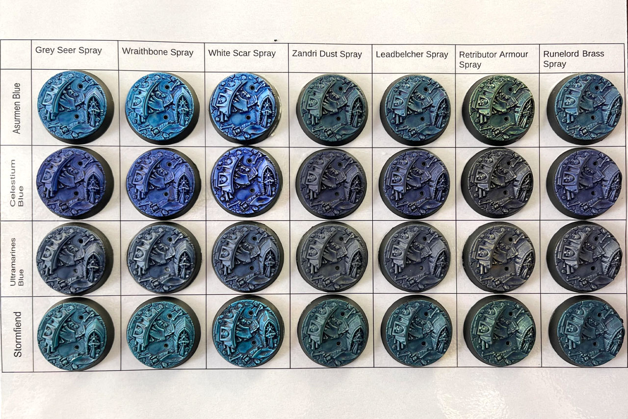

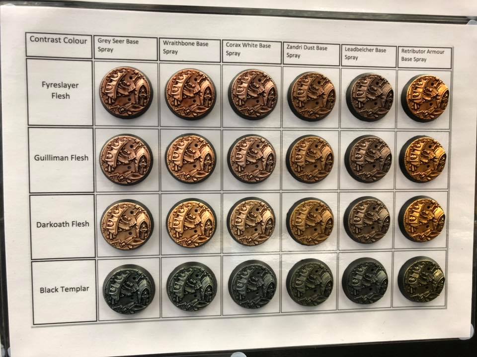

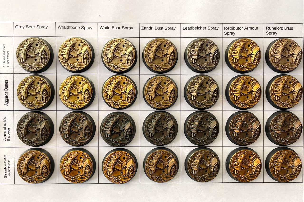

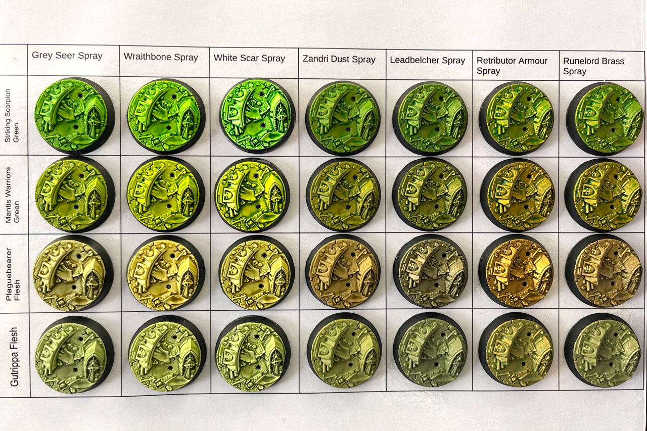

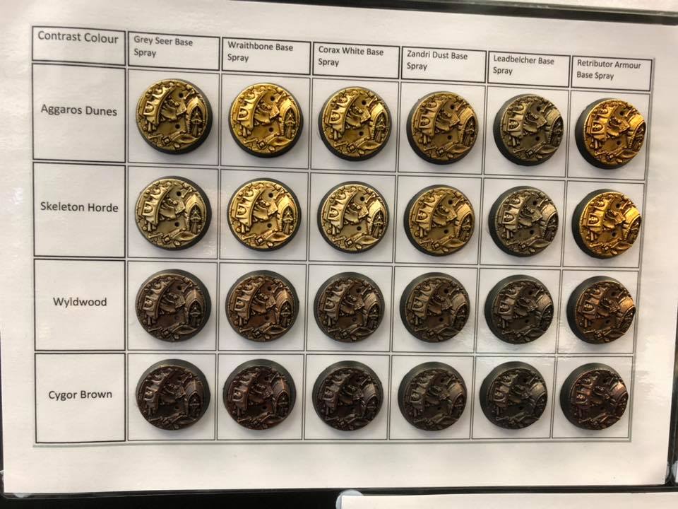

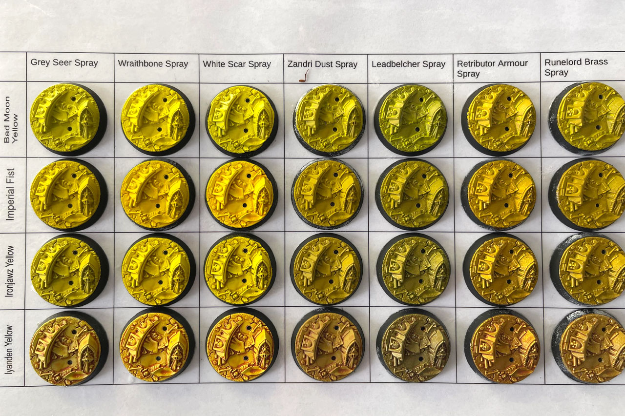

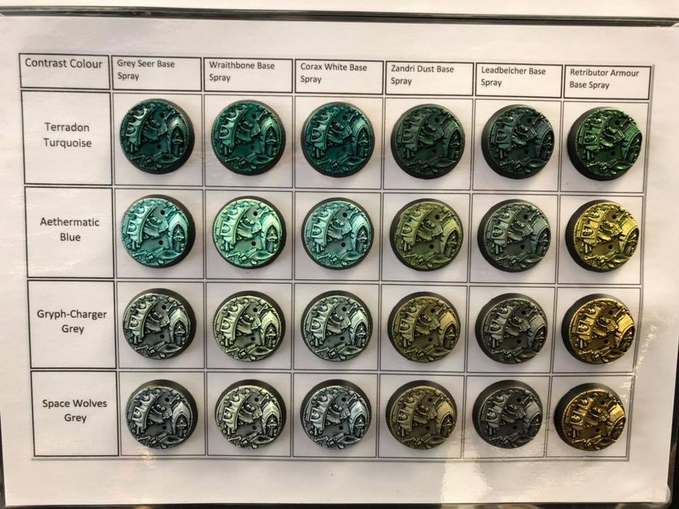

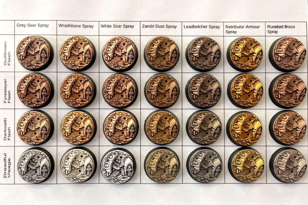

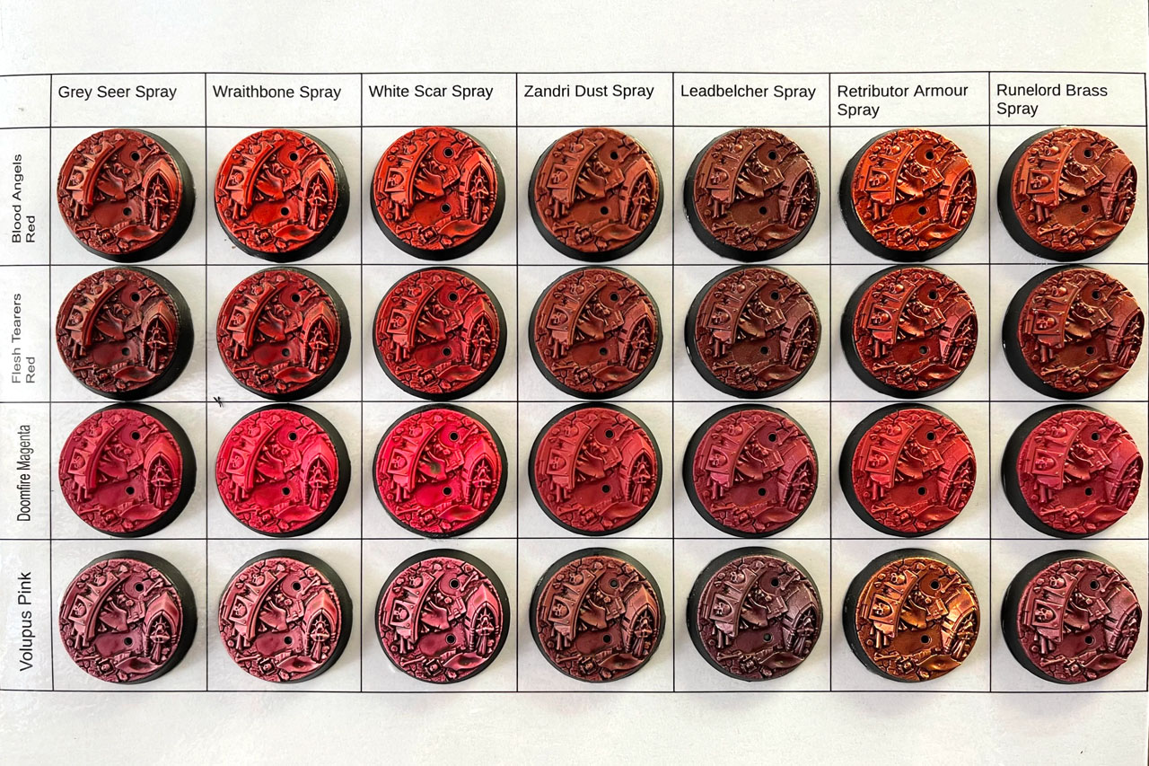

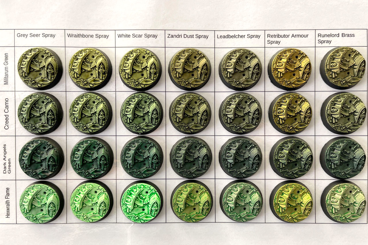

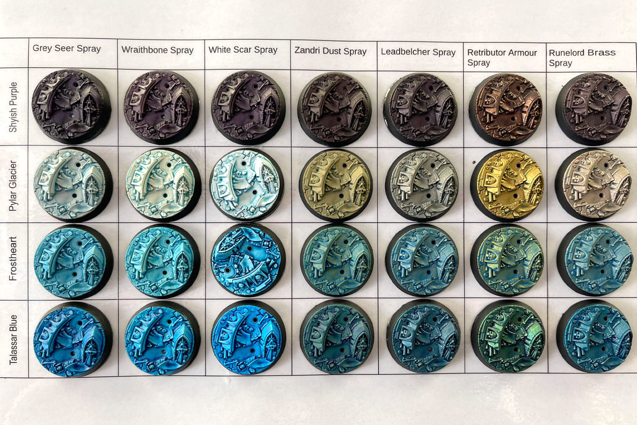

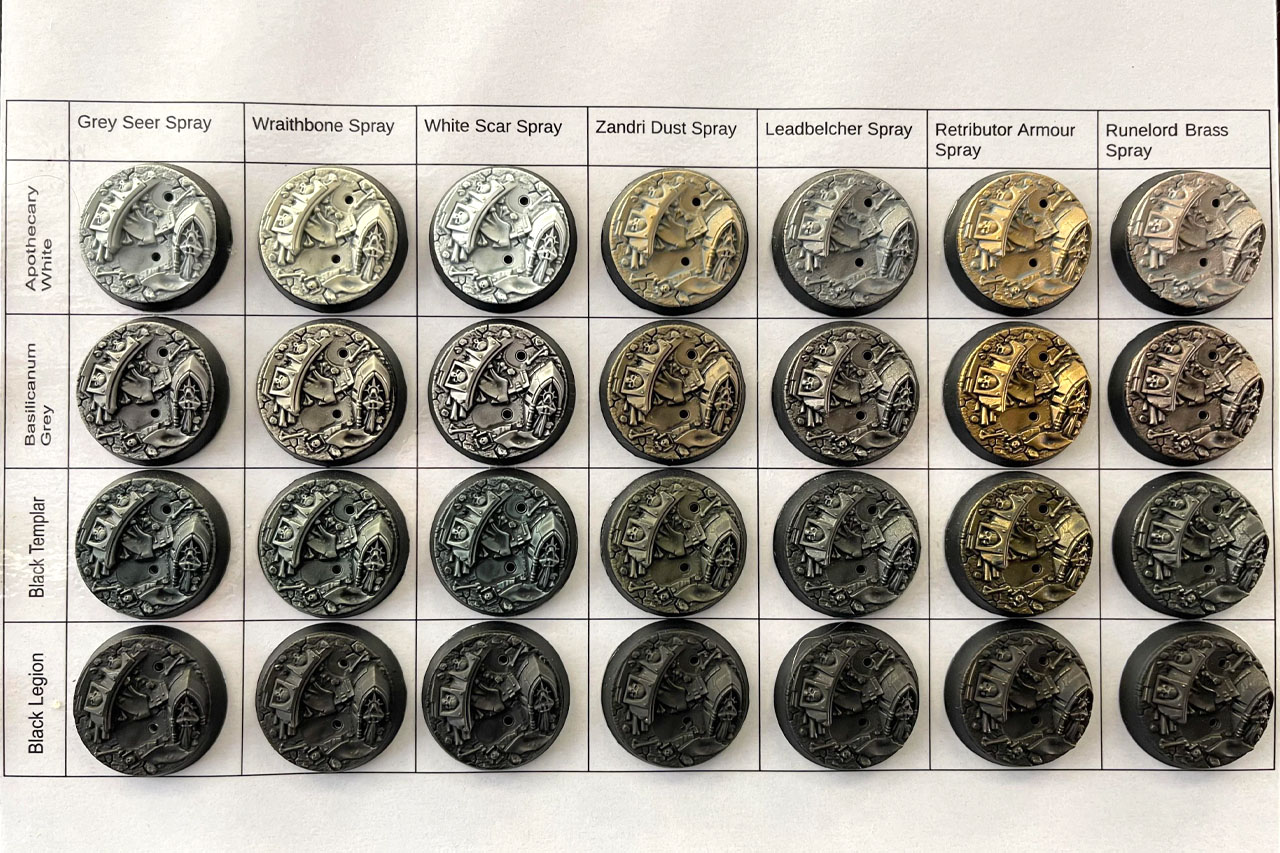

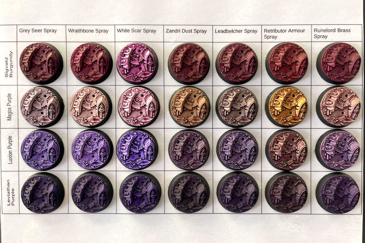

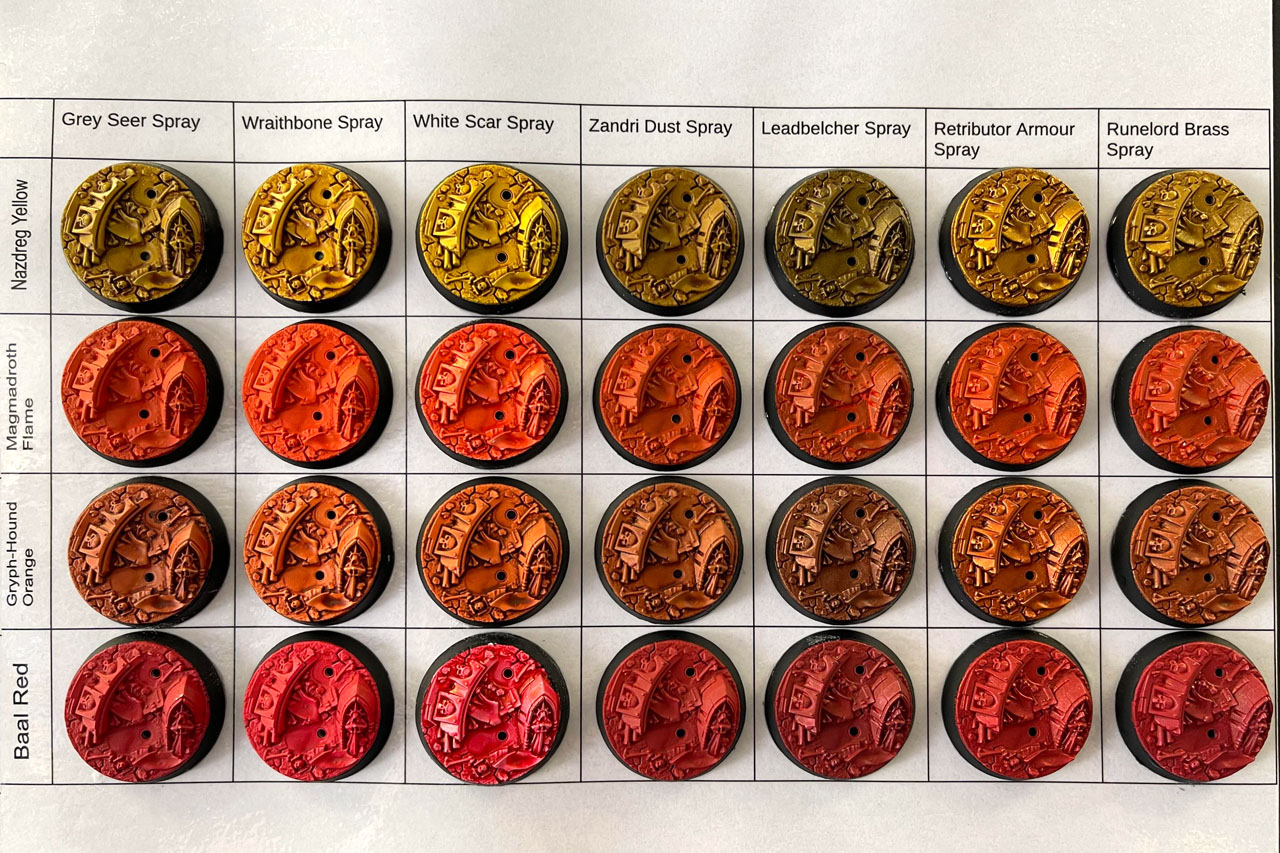

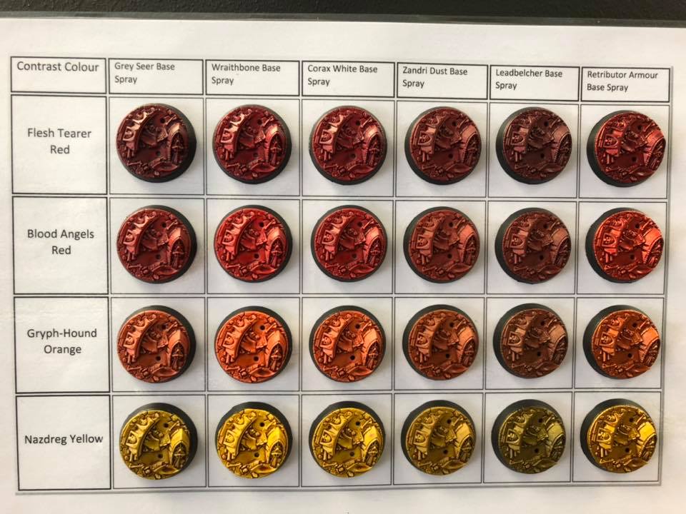

Color Guide. Contrast Paints over various primers.
