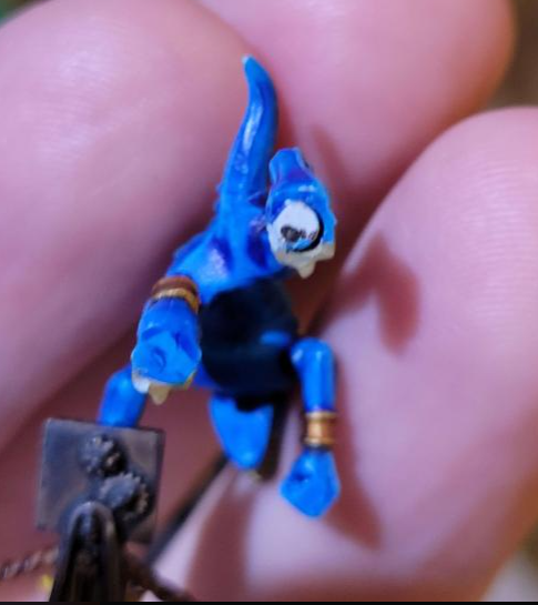

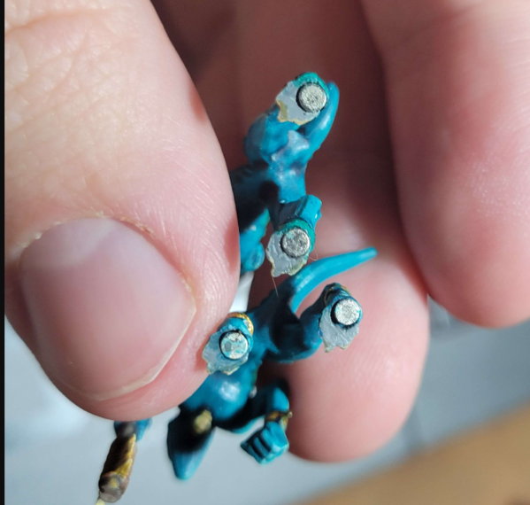

Use your drill bit to drill holes in the feet of your priest and chief. Be careful as if you drill too far, you'll go right through the foot. The magnets might not fit fully in the foot, but this is OK, as it will only hang out maybe 20% of a mm out. Sometimes the foot might separate a little, but this is OK as it's hardly visible, and can sometimes be fixed with a bit of greenstuff.

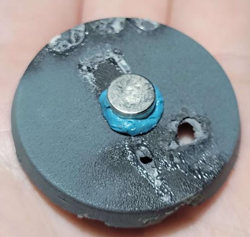

When you're ready to insert your remember to place your smaller magnet onto your reference magnet. The reference magnet will be as if its in your howdah, so make sure your skink magnet is on the reference BEFORE gluing. Sometimes I like to put a small bit of super glue on the skink magnet after placing it on the reference, then slot the drilled hole over the skink magnet, so I know for a fact it's how I want it.
In this image, magnets are in both feet, and are sticking how I want them too according to the reference base

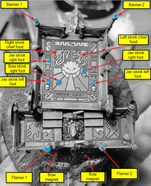

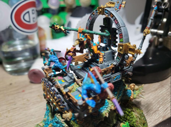

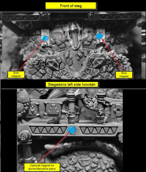

The Howdah/Stegadon
Apply your magnets as follows. Remember to use your reference!

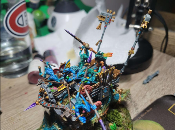

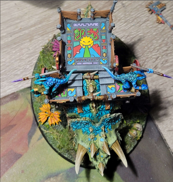

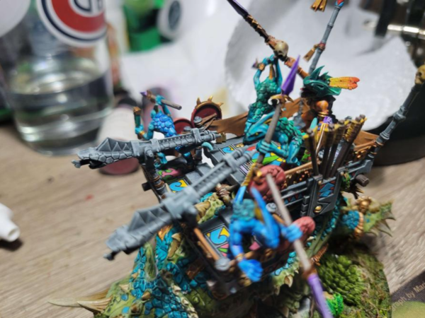

When you've magnetized your howdah

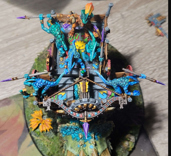

, it will look like this without the skinks (remember, we're gluing on two long tailed skinks)
With all magnetized skinks

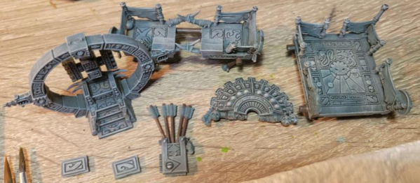

All other bits

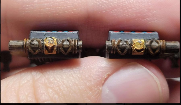

Engine piece
I used some greenstuff to give the magnets a bit more of a hold. You could use any other modelling putty as a filler (whether it's clay, terracotta, doesn't really matter)

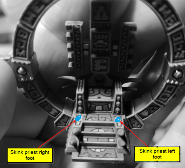

For the front, I added in two for the feet of the skink priest. As to why I didn't glue it: I can put the skink priest on a separate base for game or display purposes.

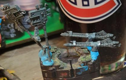

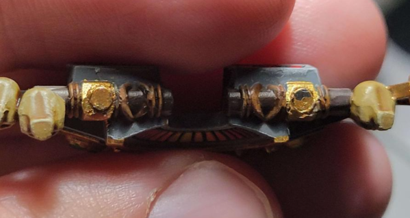

Flag poles (optional)
I only magnetized these for transportation purposes. This is a skippable option. I shaved down the connecting pieces for the flags and added the magnets. In the future, I'm wondering if it would be better to glue them together then snip them to

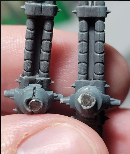

Crossbow
Two magnets in the metallic parts.
Arrow container (optional)
One magnet in the back.

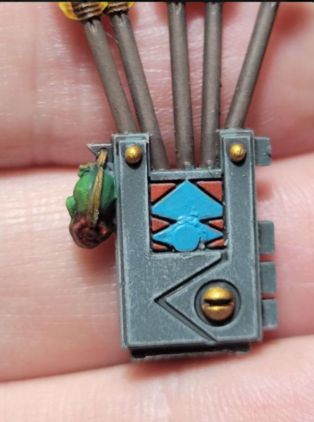

Decorative side panel (optional, used for when we want the Engine of the Gods loadout)
Crest for Engine.
Flame spitters

So I am working on the stegadon now and also wanted to try maximize its variance with magnets. I stumbled upon your thread which made me want to make this possible aswell, but I have a couple doubts now that I'm in front of the plastic.
So for WHF 8th edition army book the crew seems to be x5 for every variant. With your solution it seems that 5 skinks is only possible for the base variant (giant crossbow). Is it because you had to compromise and the kit doesn't allow enough flexibility to magnetize 5 skinks on every variant? or another reason?
Another question is: Do you use the same magnet placements for both the crossbow and the Engine front decorative piece? it seems to make sense to me but its not 100% clear how you did it.
