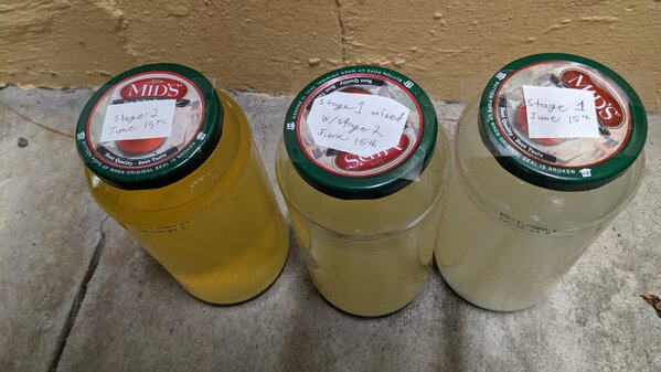

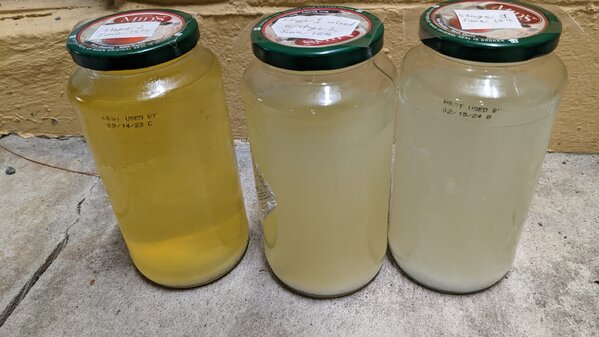

I put these 3 bottles out Wednesday morning. Leftmost was yellow green, right two were pretty much emerald green. Unfortunately I did not think to snap a photo at the time.
This is how they looked after the sun went down.
