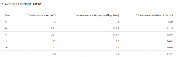

Im also not really sure about the 2 Starpriests. They do give you a chance to generate CPs (although rather low chance and you already got Kroak + Slann) and cast a couple of spells, but I would consider getting at least 1 Priest. +1 to hit is more damage than Serpent Staff on the Salamanders. The Star-stone Staff ability giving them +1 to save and run+shoot+charge is also great. You already have the Trog for Arcane Vassal, so you should be able to cast through the Trog on the majority of the field, and if they come close simply casting from Kroak with Balewind and Astrolith should be enough.
I would switch up the spells as @Nart said and swap 1 Starpriest for a normal Priest. It would give you 60 pts. leftover, which is enough for either Bound Purple Sun or Bound Aethervoid Pendulum. Thats what I would do - I do like the list a lot! Im tempted to give the Trog some games.

Thats interesting about the math being better with the priest. Also good point about bound purple sun. Will be useful vs orks and dwarves. Will probably make the swap you suggested.

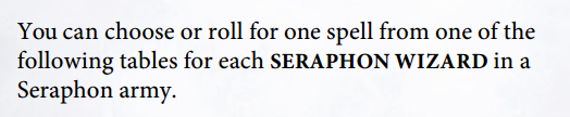

I think I’m going to keep the priest and the star priest. The Oracle cannot take spells from the spell lore. He only knows the spells listed on his warscroll: arcane bolt, mystic shield, and comets call. Because of this the starpriests still have uses bringing hand of glory or tide of serpents. Starpriests also have a useful spell in Blazing Starlight which stacks with geminids.

I also agree, that starpriests are not necessary without 40 skinks block. Not useless, but not necessary too. Same for priests. Salamanders don't really need them.
