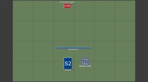

Just learned how to use Battle Chronicler so hopefully this will help clarify a few things for you.
PS - Many thanks to asrodig for the tutorial on how to post images on the site as I would never have figured this out on my own!!
Here is the deployment with the skink screen (S1) providing hard cover to the Saurus (S2) and Temple Guard infantry blocks.

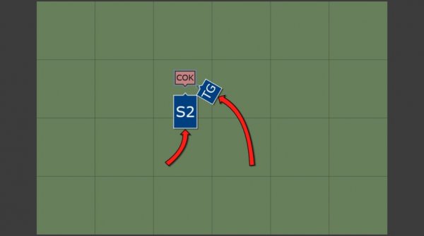

The cold one knights advance.

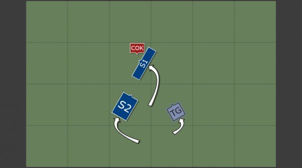

The skink screen has advanced and reformed into two ranks to re-direct the COKs. At the same time, both blocks have advanced slightly so they are in a position to counter charge after the skinks are crushed in combat. The skinks are effectively preventing the COKs from any movement other than charging the skinks since there is no way the COKs can charge either infantry block. The key is to ensure that the TG are not too close along the potential overrun path to reduce the chance of a COK overrun into the TG (i.e. ~10" from the skinks).

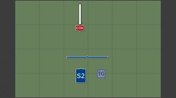

The COKs charge and destroy the skinks but opt not to overrun and instead reform.

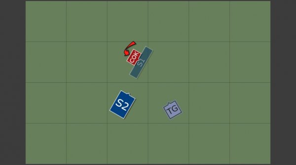

Both the Saurus and TG charge in and engage the COKs.
