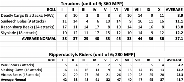

So, I wanted to see how Ripperdactyls and Terradons compared, as I've been using a unit of 6x Rippers for a bit. This table shows 10 sets of rolls for the respective units attack profiles. The Terradons are a unit of 9, but I assumed only 6 would get into melee and the unit of 6x Rippers are all in melee. These attacks are not done in the Shadowstrike Battalion, so they are not benefitting from the +1 to wound rolls.
It's an interesting comparison to me. I used the 12x dice from the Soul Wars box in all of these rolls. Your getting close to the same overall damage, but the ~9 average Mortal Wounds and 9 additional wounds in the unit of Terradons is only costing you 80 more MPP.
What are your thoughts?
Would you like to see any other roll comparisons?
Well, not that your dedication to working out the average wounds is not impressive, but is there any reason why you didn't just calculate the average from the to hit and wound rolls?

Why did the Skyblade have 18 attacks?
My assumption is that 6 models would be able to get into combat, much like the 6x Rippers I currently run. 6 x 3 attacks = 18
Only the Alpha of the unit can equip a Skyblade. And sadly they have to give up their Bola to take it.
OOOOH! Wow, that dramatically changes this table and conclusions. So the only melee attack is the Beaks?

If I were to use the information of your tables (and ignore the skyblade row), then the terradons do a bit more than half of what the rippers do, which does seem quite underwhelming at first glance; However, they do not need to get in combat, and so can better choose their targets for their attacks, which can do a lot in certain circumstances, and the can deal mortal wounds, which are often worth more than normal wounds, and again they can direct these mortal wounds wherever they like, and lastly they are a bit cheaper than the rippers.
Definitely good point regarding the two attack profiles that don't require charging and pile-in, thus allowing for a retreating maneuver in movement and wider variety of targets. That 5" range on the Bolas seems dangerous, though and you do lose the Beak attacks. The MW output and less cost are good incentives to them as well.
