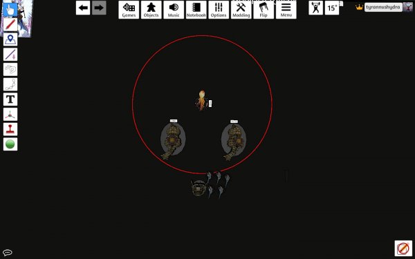

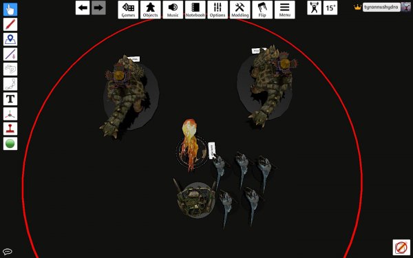

Keep Burning head on a triangle-like position with your Bastiladons. They shoot 24", so that's plenty of your board. I can show you some photos if you want because you're not clear about this. And remember, Burning Head can move up to 9" I think, but it doesn't mean he must move that amount.
This is the idea! A photo with ideal setup would be nice.

I'm adding a photo in TTS, since I don't own a Burning Head in real life, but the couple of games I've had with it, was fine. Just remember that you must deploy it wholly within your mage, so Saurus Guard will be bothering you for the deploy, keep that in mind and put them aside.
