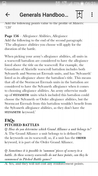

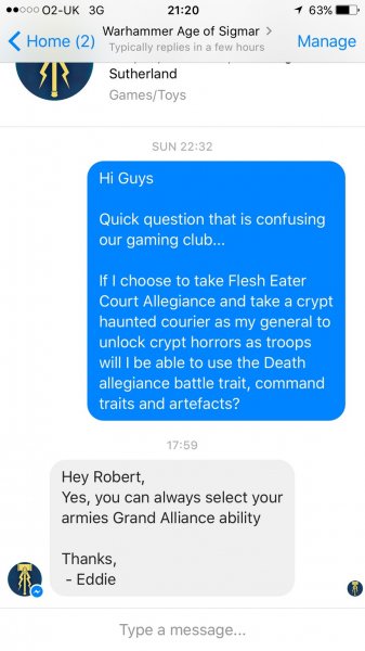

Wouldn't that kill the Seraphon allegiance, thus preventing him from using the Saurus Guards as Battleline?
...or maybe I don't understand allegiance correctly. Doesn't Seraphon allegiance mean that all my units have to be Seraphon?
No, the way it works is that because only a few armies have their own allegiance thwy changes it so that you can have the seraphon or whatever allegiance and still use the order artefacts and abilities.
I think you are mistaking here. You asked if you could still use the death Alliance ability, which you can since all of the models are from the death Alliance.
In the seraphon case the gryph-hound isn't a seraphon unit, there for guards and knights can't be used as a battle line
I am still correct, but I did not post enough info.
You can still so it, the Gryph-Hound simply wouldn't benefit from the allegiance, which is no big deal.
