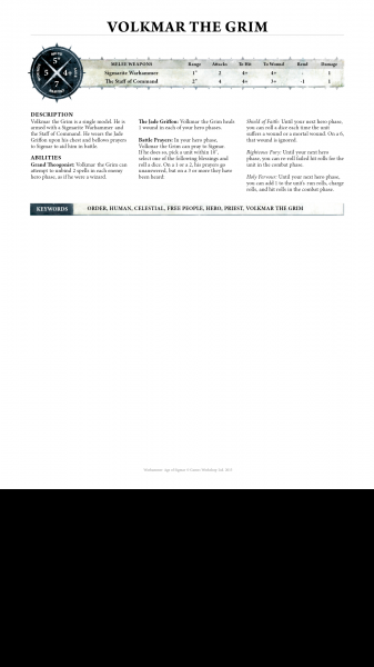

Volkmar the Grim - The Empire/Humans - 100p
Has a prayer the doesn't have any keywords tied to it. Cast on a unit within 10", succeeds on 3+, three options to choose from:
A. 6 up ward save for wounds/mwounds. (same as archmage but single unit)
B. Reroll failed hit-rolls for that unit until next hero phase.
C: Add 1 to run, charge and hit rolls until next hero phase.
Says a "DEVOTED OF SIGMAR" which I guess you can't cast on us ? And does he exist solo in AoS ? Couldn't find him
That's odd, maybe the warscroll in the app is old. If you check the warpriest it has that keyword, but not for him as a named character.
Edit: If you follow his "purchase link" in the app it redirects you to the "War Altar of Sigmar" unit.
