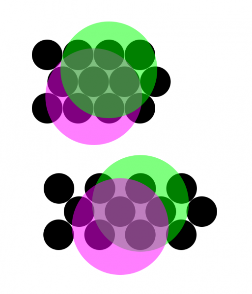

    Spears get more models attacking than regular weapons as they have a 2" range than a 1" range (even with the same size base of course.)
    I'm not sure I understand the question.
    Spears do really well in units of 40. Regular weapons do well in smaller sized units such as 10.

    I tend to say it probably is.
    As for the spears: yes they somewhat reduce the problem, but... Skeletons with spears can hit from the third row, Saurus can't.

    Saurus can if you do the lower example. Which, interestingly enough is more efficient under certain circumstances.

    Sure. But they take up even more space that way. Navigating a Saurus horde between terrain is kinda tedious.
    Lords of Space and Time makes it much easier though.

    Sure. What im saying is the same horizontal space yields equal or better results. More area deep is usually not an issue. Therefore its worth doing... always.
