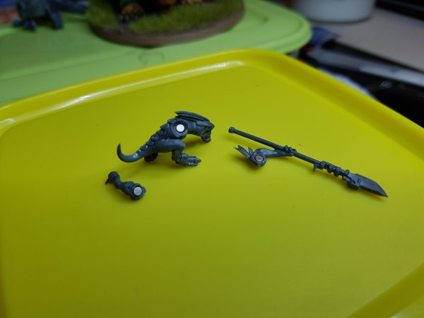

    I magnetized the first rider today. Well, most of it.
    Here you can see the arm parts (no hands for the Terradon versions yet just the arm).
    I messed up one of the arms a bit so I will have to put a little bit of liquid green stuff in there to cover up. My most common error is to not put the magnets in deep enough.

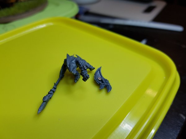

    For the shield I tried something new.
    The shield itself has a regular magnet but for the other side I wanted to avoid having the clunky magnet on there. So I snapped off a tiny part (2mm x 1mm) off the end of a fret saw blade and glued it to the arm. When painted it will be pretty much invisible I guess.
    The magnet attaches to it quite well and since the shield is very small there is no risk of it falling off.
