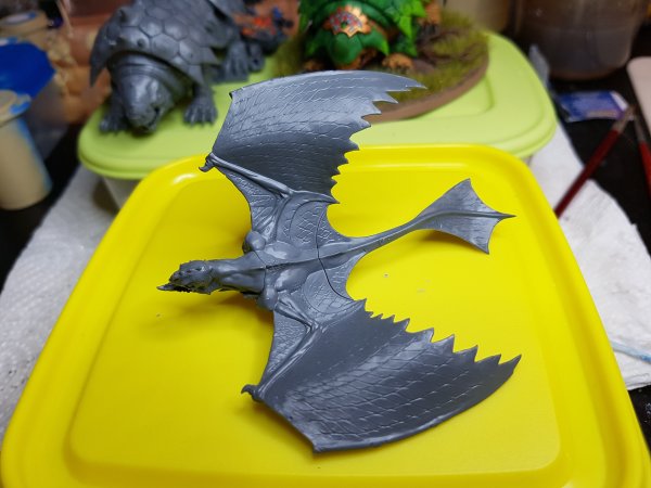

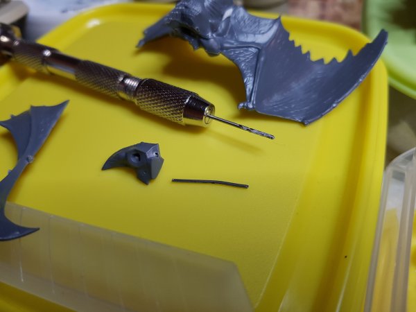

    Ok I think I have figured the tail thing out.
    Remember the Microsoft Office Assistant (Clippy in English, Karl Klammer in German)?
    He is here to help you!
    ...you just have to kill him and cut his corpse apart to use it as a support structure! :D
    Ok seriously. I just tried it. I drilled small holes (a few mm deep) into both tails to stick a paper clip part into it. It works.
    The holes don't have to be perfectly centered, just identical for both tails. Then use one of the tails to find the right position and glue the paper clip part into the body.
    Remember to leave enough space for the magnet to fit into the middle of the tail.
    Here are a few shots. Not perfect since it is my first try. I think Ill try and put it together and see if it works or if I have to try something else.

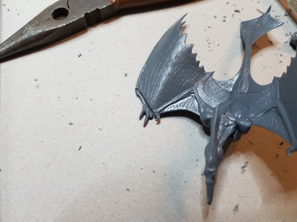

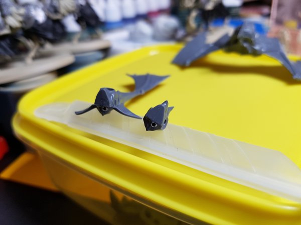

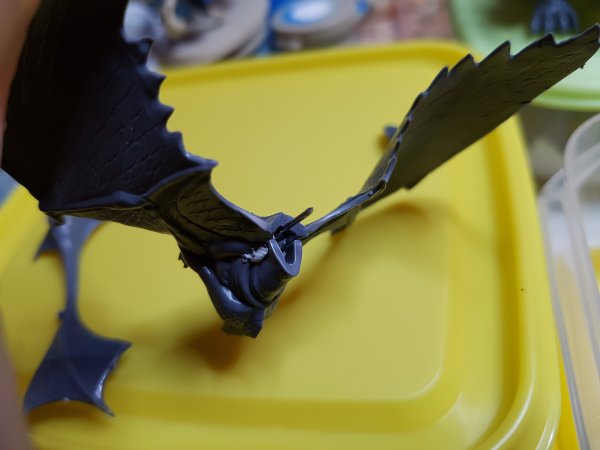

    I assembled the heads and tails and it looks decent.
    I messed up the rear end a bit so I will need some putty to fill the gap. Not severe but I think I can do better so the junction is barely visible.
    I will also try and cover up in that area with the paint job.
    Now I am contemplating which claws to use...
    Originally I wanted to use the Ripper claws but now that I see it....
    I think the smaller (Terradon) ones look better if you take into account that they must fit both variants.
    IMO the Terradon claws look less impressive but OK on the Ripper and I can imagine that it can slash with those as well, while the Ripper claws look a bit out of place on the Terradon...
