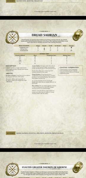

    Dread Saurian warscroll! It is summonable!!!!!
    at the low low cost of 40 points! Kinda possible on turn 3 with some luck. Slann balewind and cogs you can get 15 on one turn. D3 from an Astrolith to help a little lol.

  18. Joshua Horchler
    Troglodon
    Joshua Horchler Well-Known Member
    619
    1,351
    Are there any changes to it's abilities or attacks? I am not a Dread Saurian Carnoissuer. (Get it? I combined Carnosaur and Connoissuer) :)
    Dr Kaos, Aginor, Wazz and 1 other person like this.
  19. Killer Angel
    15,022
    33,051
    :D
    Yeah, many changes.
    the bite is only rend-1 (it was -3!) but damage is no more d6 but 6 (at full health)
    more rend for the claws
    new tail attack
    heal is automatic but only in your turn (the old one was tied to DS deal damage, but it was in every turn)
