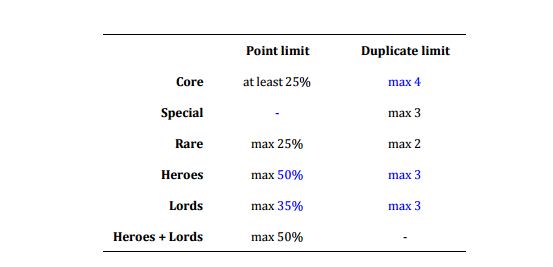

    Thing is, I'm not even sure if your list is legal, I think Lord Choices are still limited to 25%, not a big problem since you could easily bring the Carnorider in your heroes choices as well.

    I've only recently started playing 9th Age, but from what I can tell, his list is legal:
    For a 2500pts army, that's 875pts you are allowed for lords (he has spent 845pts 1st list and 840pts 2nd list). But yeah, scar veteren carnosaur riders seem to have been buffed majorly, AND cannons are way weaker than before.
